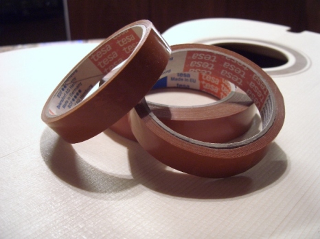

When I shaped the braces on my top, I was fortunate enough to not gouge anything (actually had only a couple scratches!), but boy did it take some concentration and sweat on the brow. Does anyone use a shield of some kind for just such occasions?

For the braces, I just run some thick tape down each side of the brace. It's enough to prevent any small scratches, but if you have a big slip, it's not gonna prevent gouges or anything like that.

John, I had considered taping up, but thought maybe the tape might pull up some of the wood when you peeled it up.-But then again, I don`t think you`d have to roll it down with a 90 lb roller, either.

I use tape also. The first masking tape I used did pull a couple of grain lines on my Spruce top so I switched to very low tack masking tape. The stuff I use now is purple and is actually quite thick, by tape standards, and I haven't had any problems since. It is about $5 or so a roll in my part of Canada. Also, I rough out the braces with small Ibex convex bottomed plane and just use a 1/2" and/or 3/4" paring chisel to get into the tight spots or to get the contour I am after. I use a Veritas low angle block plane to slope the tops of the braces. The planes decrease your exposure of the top to chisels and are really pretty fast. I follow this up with 80, 120 and 220 grit sandpaper.

Get some masking tape and tape it to your clothes, than remove it and tape it again on to your clothes in order to get some lint (or dust ) onto the tape....this way you'll take most of the "stickyness" out of the tape thus preventing the tape from pulling the fibers from the top. The tape will still be strong enough to stick to the top. Then remove it from the brace when you are done and tape it right back onto another one!

Pressure sensitive masking tape

I`ve also been kicking around the notion of making a shield out of .030" plastic, slotting it to the width of my braces. That way I can use them time and again. Won`t work for the x-brace, though.

I use strips of posterboard laid or taped down next to the brace i'm working on. I make up a "set" when i start carving so I don't have to stop & cut more strips.
Posterboard is stiff enough to stay in posision & prevent dings from bumping the plane into other braces
You can finish sand quite agressively without wearing through the posterboard or sratching the top / back.

I always put some strips of brown binding tape on the corners of my wide chisel, this way its easy to get the bracest down to zero at the ends... I have never used something laying on the top, i always use a small Ibex for shaping and it has so smooth edges.
I like the tip about "dulling" the tape by sticking it to your clothes!
